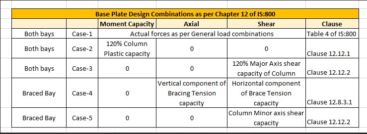

Hi Sefians,
I am trying to design a fixed base plate as per Chapter 12 of IS:800. As per my understanding following are the load cases I am considering while designing the base plate: (Column and Brace sections are considered Plastic sections)
(Please refer to attachment incase above pic is not visible in post)
Request your feedback on my understanding.
If someone can guide me to some solved example or some book that would be great help.
Regards
Manish Jain

Hi Sefians,
I am trying to design a fixed base plate as perChapter 12 of IS:800. As per my understanding following are the load cases I am considering while designing the base plate: (Column and Brace sections are considered Plastic sections)
(Please refer to attachment incase above pic is not visible in post) Request your feedback on my understanding.
Regards
Manish Jain

On first look, the design combinations�appear to be correct.
