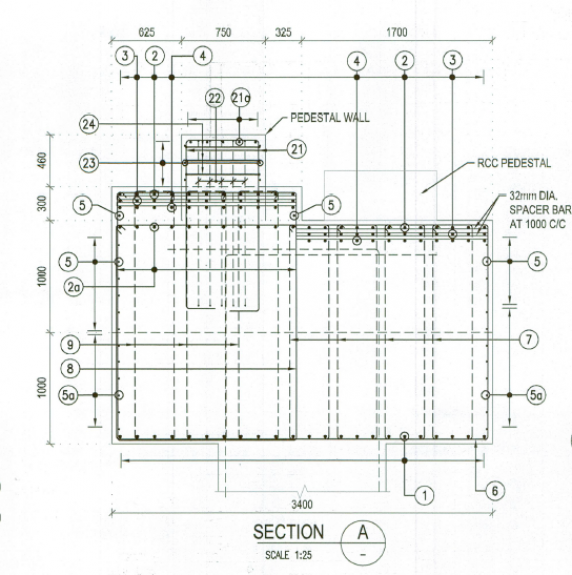

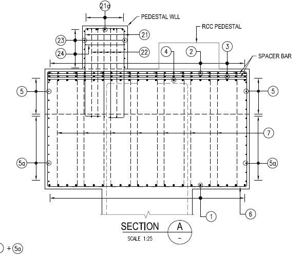

Out of the two images attached which one is the correct rebar arrangement in pier cap.The pier cap has been analyzed as a rectangular section & the offset part of 300 mm is neglected.
Description:
Rebar arrangement required is provided in the same level.
Filesize: 32.38 KB
Viewed: 18 Time(s)
Description:
Rebar arrangement required is not provided in the same level but on top of offset beam.
Filesize: 350 KB
Viewed: 25 Time(s)

Pier cap is a cantilever structure in both directions emerging from RCC piers,, the continuity reinf bars is a must across piers , , it must also be checked as CORBEL especially in short direction and horzontal stirrups needs to be provided along with verticsl stps ,,
Some Bridge expert may give better feedback,

PostPosted: Tue Apr 11, 2023 5:30 pmPost subject: Pier Cap Rebar Arrangement Reply with quote
First one.

Dear Er.Shailesh Shetty
The arrangement shown in the first image is better
