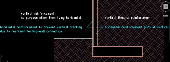

Hi all!
Please see the sketch attached.
This is an canteliver retaining wall 3m high with an wall thats 20cm thick.
It will be 60m long.
How much of the horizontal reinfrocement on the front face of the wall would you apply to control the vertical cracking due to restrain of the foundation to wall connection?
Also at what distances wozld you provide contraction joints and how horizontal reinforcement would you provide in that front face?
There seems to be a lot of debate on this and also people seems to get confused on wich reinforcement controls what.
Im interested to hear your thoughts.
Thank you

Expansion joint - yr wall is 60m ,, provide one expansion joint
Construction joint : Max casting length ,, if 7.5m ,, minimum horz reinf will suffice,,
If casting length is higher,, horz reinf can be increased as per
But if wall is not a water retaining structure,, this csn be relaxed,,
Reinforcement :
Main reinforcement in wall : Vertical reinf on earth side, on front side minimum reinf
Horz reinf is distribution reinf

Horizontal reinforcement :
For water retaining walls of reservoirs,, provision of horizontal reinforcement needs special attention and latest IS3370 part 1 &2 have given% horz reinf depending on const joint (also contraction jt) spacing,
You can also refer Fintel Handbook,, providing a curve giving distance between contraction joints vs% horz reinf,,
But for Retaining wall s not water retaining,, Minimum reinforcement as per IS 456 suffice ,,
For Rcc ret walls expansion joints can be taken max 30m ,,

Just to elaborate :
Expansion joints at 30 m spacings are for thermal effects.
Reinforcement and concrete - complete discontinuity,, with a gap to be treated as per specs.
Control joint - Also csn be construction joints as well ad contraction joints ,, where construction can be stopped but casting Length affects horz reinf provision,,
These are for shrinkage effects of conc,,
Full reinf continuity,, but casting of adjacent lengths can ne staggered,
For water ret structures, crack control as per IS 3370 must ,,
For others min horz reinf as per IS 456 ,, ok

There is need to differentiate Structures of water retaining and structures - not retaining water,,
Water Retaining Structures :
Shrinkage cracking needs to be addressed. As per Earlier version of IS 3370 (prior to 2009) ,, the Code provides minimum reinf in these rcc structure with limitation on casting length of 7.5 m,, The newer version of IS 3370 has now recommend ed minimum reinf% based on casting lengths upto 15m ,, Fintel HB was earlier refered for this,,
It is again reiterated that Reinforcement is never cut at Construction/Contraction/Control joints. Reinf id cut only at expansion joints. But in water R Strs ,, there is need to provide Water stops at these joints,, weather reinf is continued (Contro/contraction/const joints) or cut (at exp joints).
For non water structures -
Concern is not much on shrinkage cracking which I s taken care by min reinf
The main concern is thermal effects for which expansion joints are recommended at max 45 m,,
Limit of provision for rcc structures is 45 m as per IS 456 .
But for ret walls it is wise enough to reduce this as per as per ID code on provision of exp joints
Request other experts to air their views if convenient
